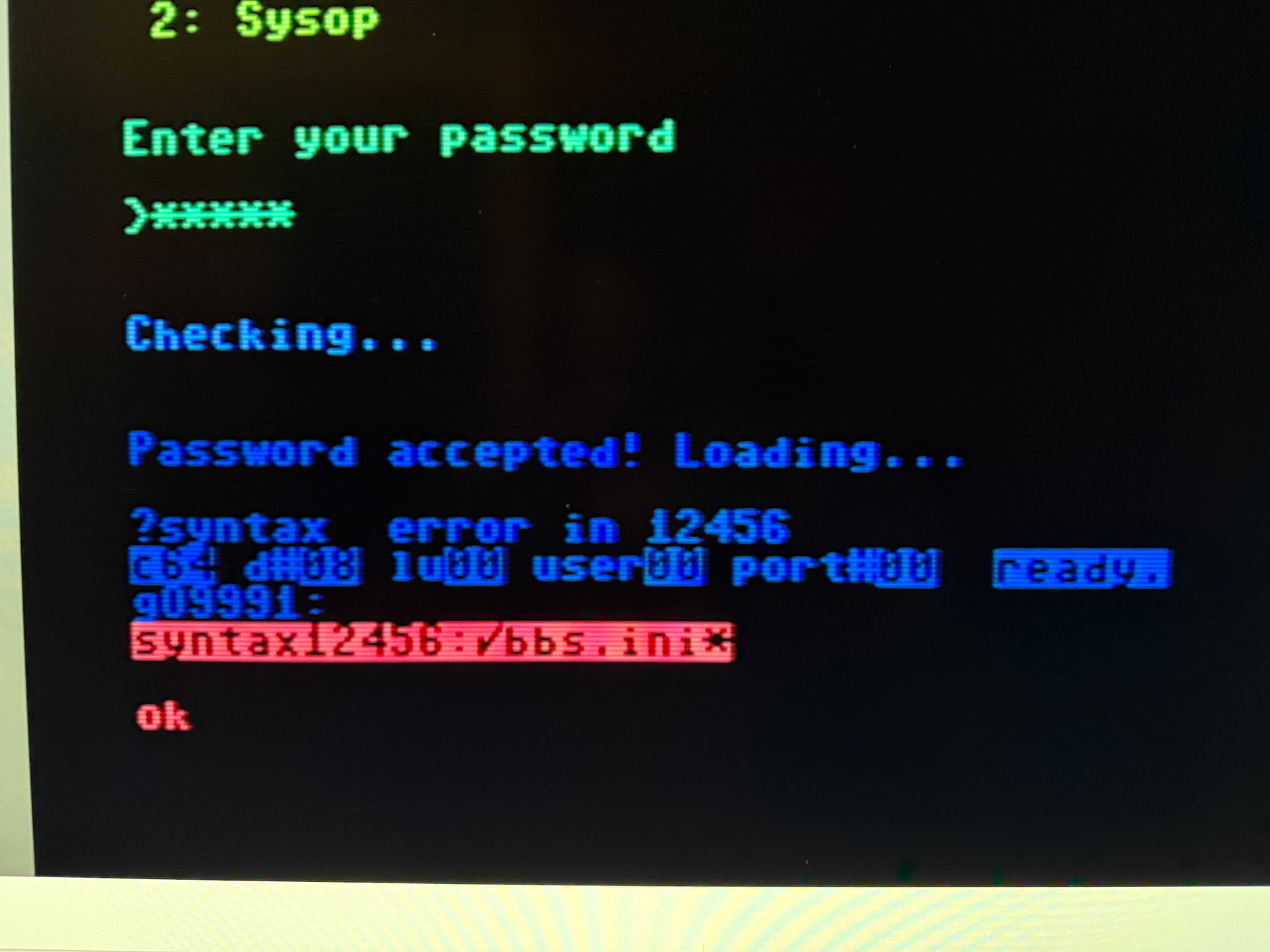

Getting this error when logging in. If I was 13 again I could probably figure this out.

regarding your error, which version did you download?
Line should read:
Screenshot 2025-11-08 012314
@Leachdude , good catch!!
I see the error!
In the BBS.INIT file, I had modified line 12456 to shorten the line, (so something like nu=nu+1 could be shortened to nu+). But you’ll see on the line I have several variables that didn’t follow this format and instead do s2=+ (should be s2+).
Sloppy sloppy on my part! The easy fix is anywhere where you see =+ remove the = so it is just +
Update posted. Just download the updated LTK images and drop them in your Disk Images folder.

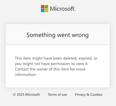

Hey @nuke
Your onedrive link for the image is broken.
Thanks @Havok - I’ve re-done the links tonight, so hopefully they are back in the game now!
