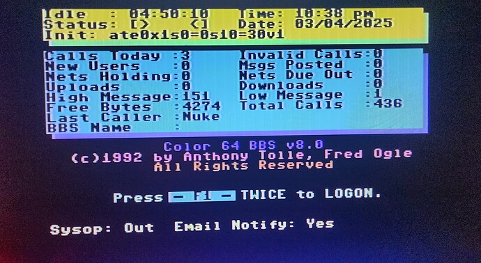

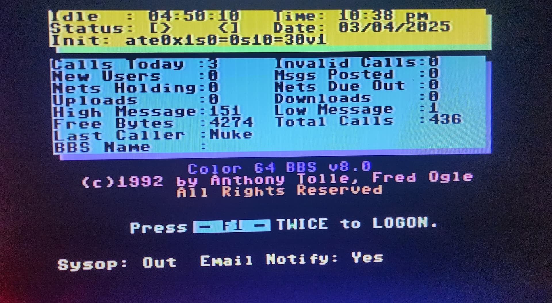

For status display in √BBS.INIT:
4. Enter:
12061 print"-home–down 22 times-Sysop: “;
12062 ifpeek(2)and1thenprint"In “;:£print"Out”;
12063 print” Email Notify “;:ifpeek(2)and2thenprint"Yes”:£print"No "
Line 12065 now resumes normal code (ifm3andpeek(653)=4…)
What does it do?
This prints near the lower portion of the Waiting For Call screen the status of the two flags.
Note that line 12062 "In " has a space → “In < space >” and similarly line 12063 needs a space with "No "; otherwise, you could get a Sysop status of “Int” and a email notification status of “Nos”.
